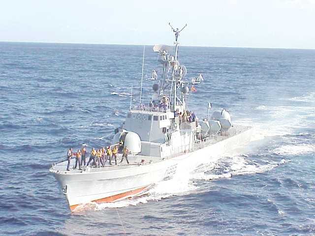

76 mm (3") Compact on SAS Isaac Dyobha
Photograph courtesy of Comdr. Graham Harrison, Commanding Officer
