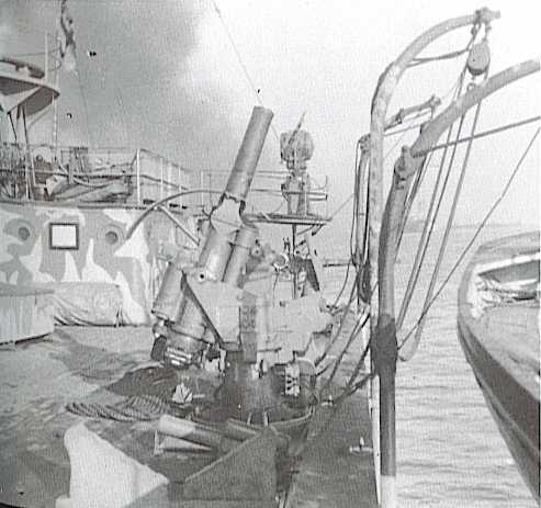

4.7"/18 (12 cm) Howitzer on HMS Severn in 1917
The shield for this gun has been removed
