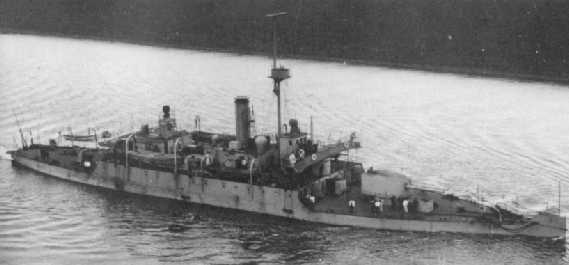

Javary in 1913
She was renamed HMS Humber after being taken over in 1914
