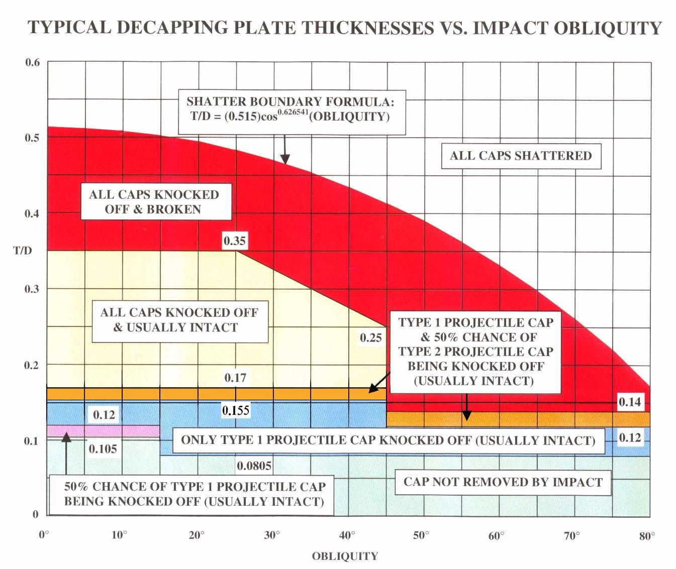

This figure can be printed out on a single sheet of paper if you select "Landscape" orientation and 60% scale -- usually in the "Advanced" Print Options under Printer Properties
If you will look at the above Figure, "TYPICAL DECAPPING PLATE THICKNESSES VS. IMPACT OBLIQUITY", you see what happens to the AP cap most of the time for the Type 1 and Type 2 hard capped projectiles.
The hood/soft cap group will usually fall under the Type 1 group as to what it takes to knock off the AP cap, with exception that the small step at 15° obliquity (the region with the 0.105-caliber and 0.12-caliber T/D values) is only at 15° half of the time, with the step moving over to 20° obliquity the other half of the time. This is from many tests with hooded projectiles where this 15-20° region was a Zone of Mixed Results, probably because the soft hood/cap is deforming slightly differently from impact to impact and the stress on the hood/cap which peels the hood/cap material from the nose, splitting the solder's grip on the hood/cap, varies with this difference. Thus the soft cap or hood is actually slightly more difficult to tear off than a Type 1 hard cap in this 15-20° region. Also, any time a Type 2 cap is always knocked off (light yellow and red and white upper regions in the graph), the hood or soft cap is flattened out on the plate face and shattered, with little or any of it making it through the decapping plate (the results are always like a hard cap shattering in this case). The details of the shape and method of attachment of the hood or soft cap to the projectile nose or any other projectile properties makes no difference.

THE MEANING OF THE RESULTS GIVEN IN THE FIGURE
When using the Figure, take the thickness of the decapping plate and divide it by the nominal bore diameter of the gun (if a sub-caliber projectile, use its actual diameter) to get the thickness of the plate in calibers (T/D), then ROUND DOWN this value to the nearest 0.005-caliber. If the result is exactly on a boundary thickness in the Figure, use the results ABOVE the boundary. Also, if the obliquity value falls exactly on a vertical boundary, use the results to the RIGHT of the boundary (the higher obliquity results). Remember, the soft cap/hood vertical boundary shown for Type 1 hard-capped projectiles at 15° in the Figure is 50% of the time at 20° instead (flip a coin each time you have to use this particular region in a test to see which obliquity to use as the boundary). Use a similar coin flip in those three horizontal zones (one purple and two orange) to determine what happens if you fall inside them or on their lower edges, if they apply to your particular projectile (for the purple zone with a hood/soft cap, you will have to flip the coin twice if the obliquity is between 15° and 19.99° and the plate thickness is between 0.105 caliber and 0.1199 caliber).
There are four things that can happen when a capped/hooded projectile hits a decapping plate:
(1) Nothing as far as the AP cap is concerned. Just the windscreen, if any, is knocked off and the projectile slowed down and deflected somewhat.
(2) The AP cap can be snapped off with no damage to it. Otherwise, as in (1), above.
(3) The AP cap can be snapped off and break up as it passes through the plate with the projectile. Some added loss in velocity may occur as the projectile tears through the plate with the broken cap on its nose. Otherwise, as in (1), above.
(4) The AP cap can be shattered on the face of the decapping plate and little of it pass through the plate along with the projectile. In this case the AP cap acts much like a shattered projectile nose and causes a similar, though usually somewhat less, loss in projectile penetration ability at normal and a much larger loss in velocity as the projectile passes through the plate. As obliquity increases, however, the penalty due to the cap shatter decreases, just as with true projectile nose shatter, since the shattered cap impedes ricochet.

WHERE THE T/D AND OB VALUES USED IN THE FIGURE CAME FROM
The plate thicknesses assume any kind of ductile steel or even wrought iron. There doesn't seem to be any kind of visible trend as to stronger decapping plates being able to be thinner. The projectile nose and AP cap are compressed on impact with the decapping plate and, in oblique impact, elastically deformed sideways and if the solder (or other method(s) of attachment) breaks its hold on the cap, the nose and cap spring back as they exit the decapping plate's back, hurling the cap or its pieces away at a low velocity, causing it to wobble at oblique impact. If a hard cap is intact, the minimum Decapping Gap values are merely those where the cap is thrown so far away by the time the cap and projectile reach the main plate that the cap will virtually never reseat itself properly as it is stopped and the projectile nose catches up to it, preventing the cap from functioning properly (the many British 9.2" APC tests showed that even a small gap of 1 caliber can ALWAYS prevent the cap from functioning after decapping using any plate thickness at 30° and up, while the Krupp 38 cm decapping design and U.S. Army decapping tests indicate that the additional distance even when the impact is exactly symmetrical is not too much longer, since I assume that the solder would break irregularly and cause the cap to wobble or even tumble as it is knocked off the projectile's nose even in this case). Krupp also found that by filling the gap with cement they could cut the Decapping Gap roughly in half, though the heavy cement kind of defeated the whole purpose of trying to use a decapping plate to make their belt armor stronger for a given weight of material (why no just make the main plate thicker and have done with it?).
The 0.0805-caliber figure, used in my previous article for all obliquities and most capped projectiles, comes from the data on tests of 6" Mk 35 AP projectiles and the 75-mm M61 and 37-mm M49 and M51 APC projectile tests, which found that 0.25" (0.085 caliber) and 0.125" (0.086 caliber), respectively, of mild steel would always decap those projectiles at 30-45°.  These thicknesses were convenient to use and did not precisely define the exact minimum, but they were so close to my 6" Mark 35 results, even though the nose shapes of the projectiles varied considerably from projectile to projectile, that they justify my retention of my 0.0805-caliber figure for that obliquity range with Type 1 projectiles. Most other tests did not find the minimum possible decapping plate thickness, but except for the Type 2 projectiles mentioned above, they ALL were compatible with this result in this obliquity range. For example, the British 40-mm 2-pounder APC projectile tests -- which had AP caps, windscreens, and nose shapes identical to virtually all World War II APC projectiles made by Hadfield used by the British Navy from 6" through 15" (not sure about the British 16" APC Mark IB used in NELSON and RODNEY)--used two lots of shells that were supposedly identical, but they were found to be different in the following way: The decapping plates used were mild steel in even millimeter thickness (to my knowledge) and one projectile lot at 30-45° obliquity was found to need a 4-mm plate (0.1 caliber) to decap the projectiles, indicating that the minimum thickness was somewhere between 3-mm (0.075 caliber) and 0.1 caliber, while the second projectile lot at this obliquity range was found to only need 3-mm plates, meaning that the minimum decapping plate thickness was between 2-mm (0.05 caliber) and 0.075-caliber thickness. These results precisely straddle my 0.0805-caliber value, indicating that my result is pretty good as an average value. As these projectiles had quite different cap and projectile nose designs from the U.S. oval-nosed 6" Mark 35, the general accuracy of my original 0.0805-caliber estimate is still correct, though now limited in obliquity range and to only soft-capped/hooded or Type 1 hard-capped projectiles. I am thus justified in sticking with that value.
The normal-impact minimum thickness -- which I had very little data on previously -- was found to be somewhat higher, with the 40-mm tests giving about a 50% increase in the needed plate thickness at normal compared to that needed at 30°. This gives somewhere under 0.125 caliber and over 0.075 caliber, depending on the validity of the 40-mm tests at 30°. Since the Japanese 47-mm APC projectile tests by the U.S. Army showed that a 0.2" (0.108 caliber) mild steel plate would always decap this projectile at normal, I am assuming that is the true minimum possible value for Type 1 projectiles, rounded down to the nearest 0.005 to 0.105 caliber, though the data is fuzzy enough with the British tests to make me increase the minimum to 0.12 caliber as an upper bound for these projectiles at normal and call the 0.105-0.1199-caliber range a Zone of Mixed Results, with a 50/50 chance of decapping if the plate thickness falls inside this internal.
Between normal and 30° I have very little data that could be used to find the minimum for Type 1 hard AP caps. However, I had the data on hoods that showed a very sudden change in the forces on the hood (and thus also on a hard cap) when the obliquity exceeded 15° obliquity, causing the hoods to be torn off as they deformed (this also accounts for the failure of soft AP caps in this obliquity range and above against face-hardened armor plates, since they would also be torn partially off on impact and this would nullify their effectiveness as a shock-absorber all around the nose). However, I do not have any information on whether there would be a Zone of Mixed results with a hard cap (the hard front region of the AP cap would be compressed on the impact side as one piece, so it might be less liable to variation in effects), so I am simply ignoring this for now and making the sudden change in decapping force occur at 15° obliquity, with the result that there is a sudden step down to the 0.0805-caliber minimum at this obliquity and greater (14.99° is the maximum for the 0.105-0.1199-caliber Zone of Mixed Results, for example). If I get more detailed information on the region between normal and 30° for Type 1 projectiles, I will revise this estimate, of course.
The Type 2 projectiles also have some variation in the minimum thickness to knock off their AP caps at normal and higher obliquity, through 44.99° (45° is the start of the region to the right where breakage occurs), so I am giving them the 50/50-chance range of from 0.155 caliber, found in Krupp German Army APC projectile tests, through 0.1699 caliber (0.17 caliber is the bottom of the always decapped region in the 0-44.99° obliquity range), which seems to be about the minimum needed for reliable decapping in U.S. Navy and U.S. Army tests of Type 2 projectiles.  Some U.S. APC projectiles were decapped and some were not at lower plate thicknesses, depending on striking velocity, but there was no trend from projectile type to projectile type, so I am going to ignore these results here as not reliable. The reason that there is no step at 15° obliquity, as for Type 1 projectiles, is that the added thickness seems to compress the cap and projectile nose to a much higher degree even at normal and once the cap solder cracks, the AP cap is shot off the nose like from a loaded spring, so that there is little difference between the sideways twisting forces that allow a thinner plate for a Type 1 projectile and the similar forces that act on a Type 2 projectile as it passes through the thicker plate. The plates needed by the Type 2 projectile are already well over the minimum needed to knock off the cap completely and only the stronger solder is preventing this from happening at any obliquity.
At and above 45° obliquity yet another rather sudden change in the forces on the cap occurs. Below 45° the initial forces were all trying to cause the nose to dig into the plate and be deflected to come out the plate back in a direction closer to the normal line; that is, the forces were always in the direction to pivot the projectile to a steeper angle as it goes through the plate. Around 45°, however, the impact forces rather suddenly change to pushing up initially on the impact point of the side of the projectile's nose pressing against the plate so as to pivot the projectile nose away from the plate to eventually glance off.  The forward motion of the projectile continues to dig into the plate and whether the projectile penetrates or glances off depends on whether the nose can dig deep enough to have the metal in front of it become thinner in the direction through the plate than the metal which is being mounded up in front of the projectile nose as it acts like a battering ram. If the nose is rotated in the glancing direction fast enough by the pivoting forces under it, it will rotate away from the plate and pull the entire projectile along with it when it skips off the plate. Alternately, if the projectile digs deep enough into the plate, the glancing rotation forces will become countered by plate material peeled from the plate and mounded up in front of the projectile and this mound of material will be thick enough to reverse the glancing rotation and cause the projectile to literally ricochet from the plate back and pass entirely through the plate. Note that the initial impact point and the point where the projectile finally either penetrates or glances off may be very far from one-another as the projectile skids sideways during this see-saw battle of forces. Since the AP cap is squeezed between the nose and the plate, it takes the brunt of these rotation and twisting forces, as well as the compression forces due to the forward motion of the projectile into the plate, so it takes a real beating.
As a result of this change in forces on the nose and the fact that the plate thickness is getting effectively greater and greater as the nose must shove its way through the plate at an oblique angle, at over 45° obliquity the minimum decapping plate thickness needed to knock off the cap changes in the following way:
(1) With Type 1 projectiles, the minimum decapping plate is so thin that the projectile has rather little change in its forces to decap it. There does seem to be a very slight trend to allow thinner plates to decap the projectile as obliquity increases, but I have only a couple of data points and thus cannot give any idea of how much this change would be. Thus, just as with the minimum Decapping Gap at over 30° obliquity, I am simply going to assume that the minimum thickness does not change out to the maximum obliquity allowed of 80°.
(2) With Type 2 projectiles, the plate thickness is appreciable and the strong force under the cap on the impact side that occurs prior to the projectile digging into the plate is applied directly onto the solder joint as a huge twisting force away from the plate. The result is that the minimum decapping plate thickness to knock off the cap drops abruptly, though I have some variation as to how much from the several U.S. Army and U.S. Navy Type 2 projectile tests. Thus, I am again creating a Zone of Mixed Results from the minimum plate thickness that I have data on, which is almost exactly 0.12 caliber at 45° obliquity, and a maximum of 0.1399 caliber (0.14 caliber will be the bottom of the region above it, outside the Zone), where this last number is based on cap breakage, as described below.
The 0.1399-caliber decapping plate maximum for the Type 2 Zone of Mixed Results for impacts at and 45° obliquity and the maximum for any intact penetration of the decapping plate by any hard AP cap in this obliquity range, which only one data point exceeds in all my tests, is based on tests with British 5.25" APC projectiles that were scale models of the British 15" APC Mark 17B (the British 40-mm 2-pounder APC projectile was also pretty close to a scale model, too, at least as far as nose, AP cap, and windscreen design) in which all of the projectiles that hit at 50° or more against scale-model ship deck arrays always broke up as they passed through the first plate, which was of this thickness. It is possible that a thinner plate would break up the cap, too, but I have no data, so I am going to use the 0.14-caliber thickness as the thickness where all hard caps, Type 1 or Type 2, break up as they try to penetrate the decapping plate at 45° or more.
Above the 0.1699-caliber maximum for the Type 2 projectile 0-44.99° Zone of Mixed Results, the AP caps of all projectiles are knocked off, with soft AP caps and hoods torn apart, but hard caps remaining intact (usually) until a much higher decapping plate thickness is reached. The 0.3499-caliber maximum for intact caps after hitting and penetrating a decapping plate of that thickness comes from several 6" Mark 35 projectile tests at 30° that precisely straddled that value, the lower thickness plates allowing intact caps and the greater thickness plates breaking up the caps. The linear decrease to 0.2499 caliber at 44.99° for intact caps (0.25-caliber plates and/or 45° obliquity means always broken) is an estimate based on more-or-less splitting the difference between the 0.35-caliber value at 30° and the 0.14-caliber value at 45°, as well as the shape of the shattered projectile cap curve (see below) which I assumed the breakage curve would more-or-less parallel. It is just an educated guess to be revised if more data ever comes along.
The red region in the figure is where all caps break up, but where they do so during penetration and most of the cap material goes through the plate with the projectile. However, against thicker plates, given by the Shatter Boundary Formula in the Figure, which gives the minimum thickness of plate at all obliquities to shatter the projectile cap, most of the cap pieces do not penetrate the plate, but are thrown sideways. I have a large number of U.S. Navy tests where cap shatter was indicated (the cap no longer penetrated the plate with the projectile nose and the remaining projectile velocity suddenly went down at low obliquity), from normal to 60° obliquity, with only one point not following that curve that divides the caps that merely break from those that shatter. This curve more-or-less follows exactly the curve of shatter with increasing obliquity for the decrease in the shatter velocity for a given plate type, which it seems to be related to. I have extrapolated the curve for over 60° obliquity, which may be incorrect, but I have no data that it is wrong, so I am going to use it until better information comes along. This minimum shatter decapping plate thickness in calibers, which I assume is true for all hard caps of any kind, varies with obliquity as follows:
MINIMUM DECAPPING PLATE THICKNESS CAUSING SHATTER = (0.515)COS0.626541(OB)
