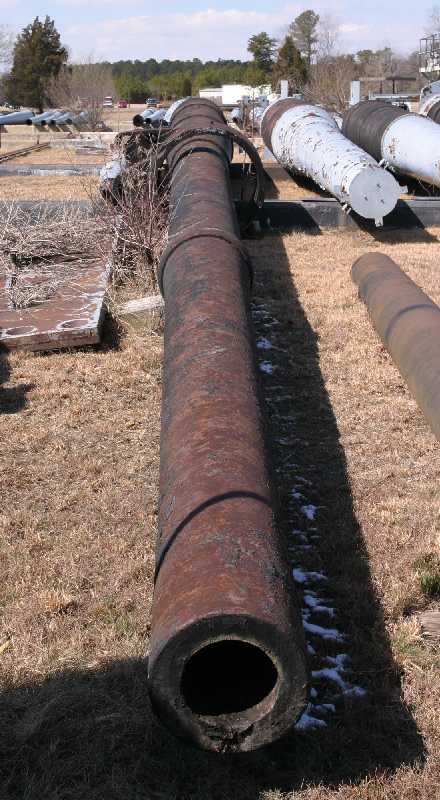

9"/98 (22.9 cm) Mark 1 as it appears in March 2005 at the Naval Surface Warfare Center in Dahlgren, Virginia
Note that this gun was never rifled
Photograph copyrighted by NavWeaps.com

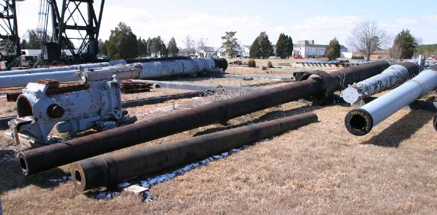

The extra-long length of this gun is amply illustrated in this picture
