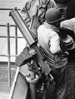

Water-cooled Browning 0.30" (7.62 mm) MG on the bridge of USS Wasp CV-7 during Guadalcanal Campaign
Detail from U.S. Naval Historical Center Photograph # 80-G-1684

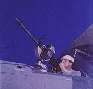

Aircraft 0.30" (7.62 mm) MG
Library of Congress Photograph ID LC-USW36-86
