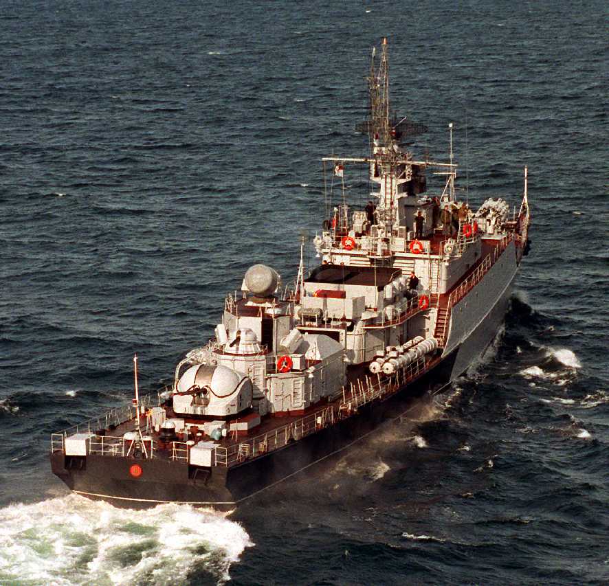

Lithuanian Grisha class frigate with twin 57 mm on stern in June 1993
U.S. Navy Photograph No. DN-SC-94-00870

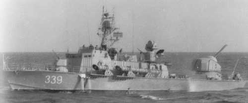

Turya class patrol ship with an AK-725 mount on stern
Photograph from Jane's Warship Recognition Guide
