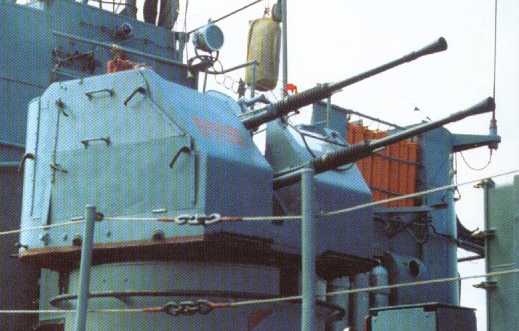

25 mm/79 2M-3 on P-6 MTB about 1962
TASS from SOVFOTO
25 mm/79 in 2M-3 Twin Mounting
