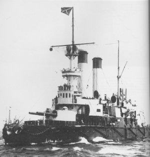

Coast Defense Ship General Admiral Graf Apraksin
Photograph from "History of Russian/Soviet Battleships"
