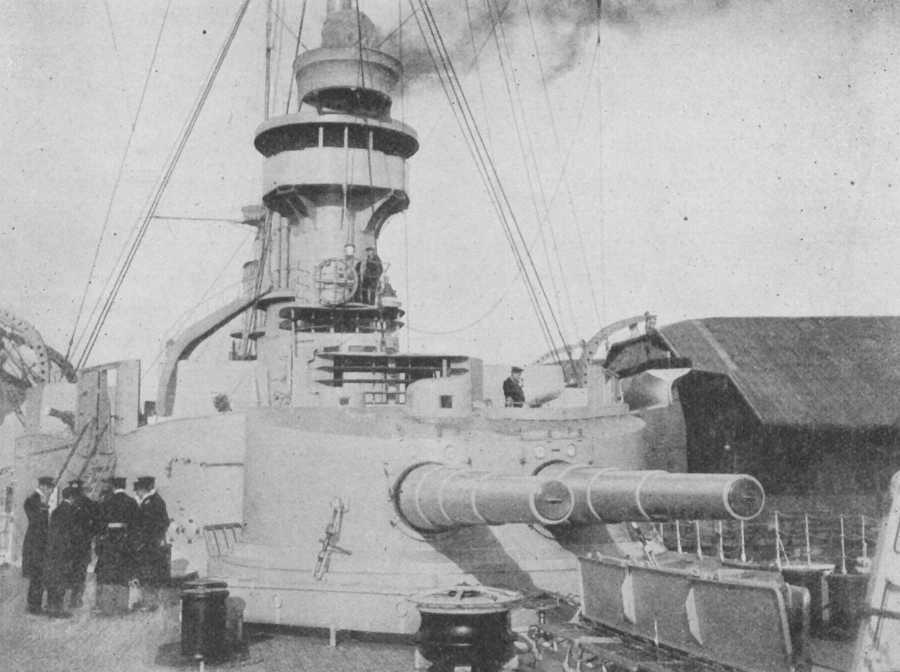

Stern Turret on Scharnhorst
Note the built-up nature of the gun barrels
Photograph courtesy of The First World War
