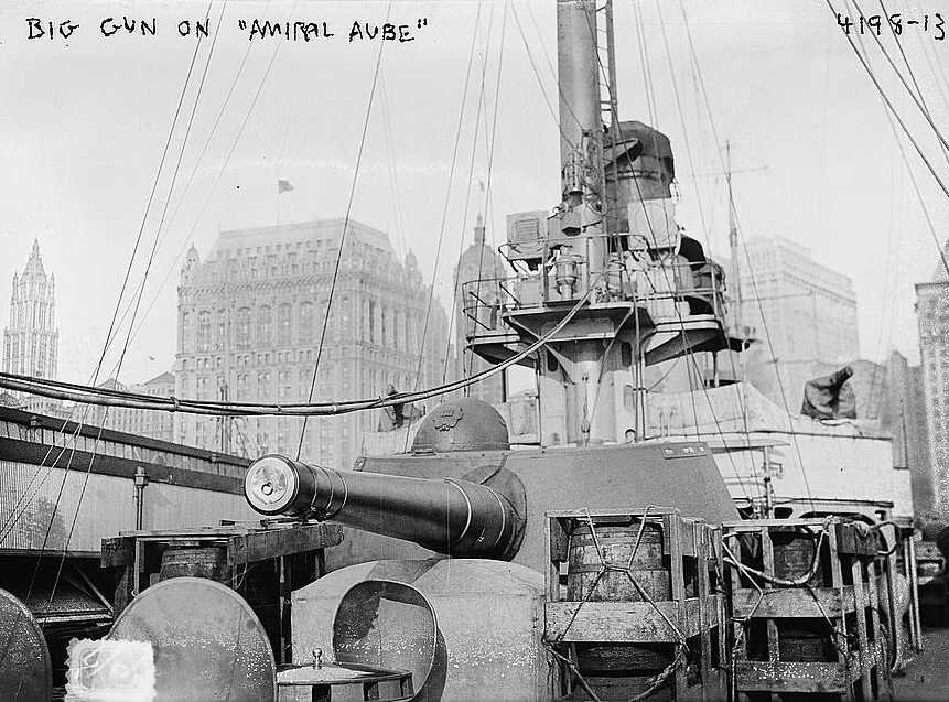

Bow 194 mm/50 mounting on Armored Cruiser Amiral Aube
Bain News Service Photograph
Library of Congress Photograph ID LC-DIG-ggbain-03070

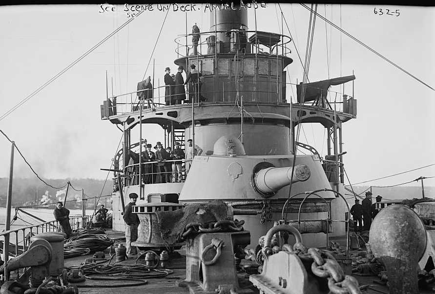

194 mm/50 (7.64") stern mounting on Armored Cruiser Amiral Aube
Library of Congress Photograph ID LC-DIG-ggbain-24308
