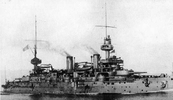

Pre-dreadnought Suffren
The 164.7 mm/45 (6.5") guns are in the small turrets
