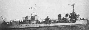

"600 tonne" Torpedo Boat Bouclier

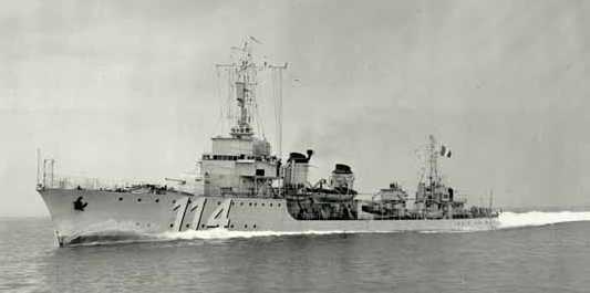

"600 tonne" Torpedo Boat Melpomène prior to World War II
