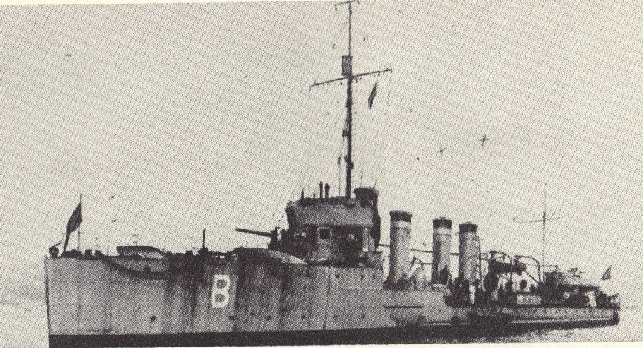

These older guns differed from later versions in that they fired separate rather than fixed ammunition.  Performance of all these guns was similar.  SAP projectiles weighed 35.3 lbs. (16.0 kg) and had a muzzle velocity of 2,306 fps (703 mps).  Guns reworked for various reasons before World War II had "T" suffixes added to their designations.

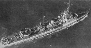

In the late 1930s, a shortage of new 100 mm (3.9") guns forced the re-use of these old guns on smaller warships.
Destroyer Bouclier

Escort Sloop L'Impétueuse in 1941 showing her single 100 mm mounting

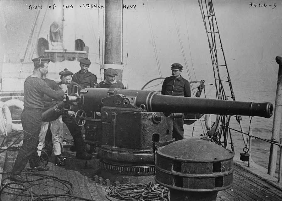

100 mm/26 (3.9") Model 1892
100 mm gun on unidentified French ship
Bain News Service Photograph
Library of Congress Photograph ID LC-DIG-ggbain-26062
Actual bore length was 26.2 calibers.  SAP projectiles weighed 35.3 lbs. (16.0 kg) and had a muzzle velocity of 1,673 fps (510 mps).  Used on minor warships.
