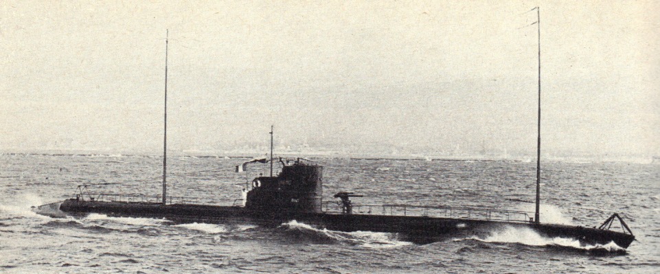

Submarine Thetis in 1938
Photograph in the collection of Henri le Masson

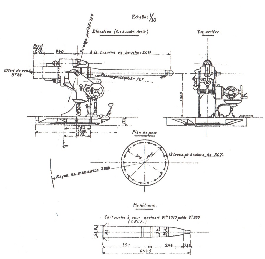

75 mm/34.5 Model 1928 gun in SMCA Model 1928 Mounting
Sketch in the collection of Robert Dumas
