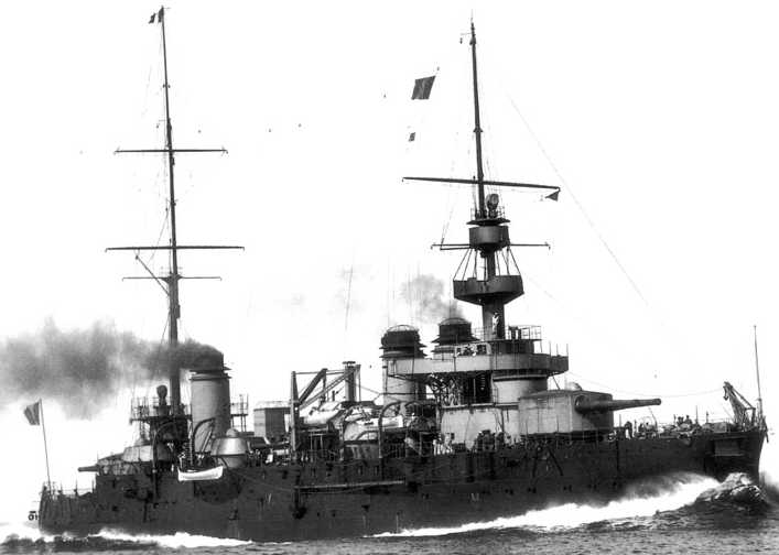

Used to arm French pre-dreadnoughts, these guns were similar in design, and apparently used to test various design concepts such as longer barrel lengths.
The construction of all Model types was a complicated built-up design, similar to other French heavy guns.  Actual bore diameter was 30.50 cm (12.008").
Pre-dreadnought Liberté

1) The two-gun mountings had nearly all of the gun operating machinery inside of the turret itself, with no barbette as such.  Instead, a narrow armored tube protected the ammunition hoists.  This arrangement differed little in total weight from other 305 mm (12") mountings built by other nations, but did have a penalty in that all the weight was carried higher in the ship, leading to stability problems.
2) A novel feature of these mountings was that they used a hydraulic pivot which supported the the rotating structure when it trained.  When the proper angle was reached, the mounting was lowered onto a seating ring.
