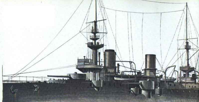

Bouvet
The 274 mm gun is in the larger port turret
