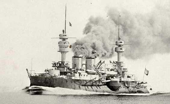

Pre-dreadnought Jaureguiberry with 274 mm/40 guns in single amidships mountings
