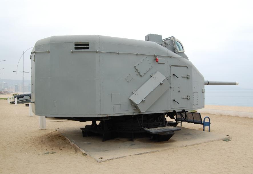

4"/62 (102 mm) mounting now at Museo de Cañones Navales in Bahia de Valparaíso, Chile
Photograph copyrighted by Carlos Mey and used here by his kind permission
