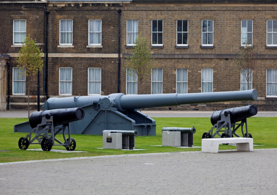

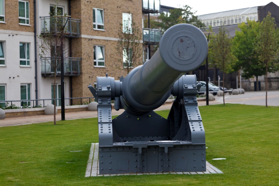

Former Gibraltar gun now at Firepower - Museum of the Royal Artillery
Photograph copyrighted by FDII
