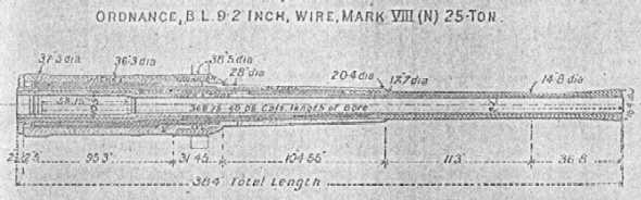

Constructed of inner A tube/A tube/wire over rear half of A/jacket and B tube to 150 in ( cm) from muzzle/trunnion hoop over join jacket and B hoop.  The breech bush screwed into the A tube and a collar between the A tube and the jacket screwed into the latter.  The breech block was an interrupted screw cylindrical type with a hand worked continuous mechanism.  The Mark VIII* indicated an alteration to the front slope to prevent slip back at high elevations, but no guns were so modified.

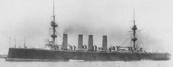

HMS Powerful in 1898
The 9.2" (23.4 cm) guns are in the bow and stern mounts
Photograph by Beken of Cowes
Constructional view of 9.2"/40 (23.4 cm) Mark VIII
