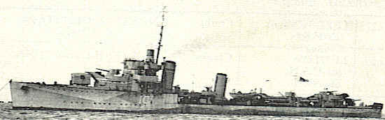

HMS Montrose, with twin 6-pdr mount replacing bow 4.7" (12 cm) gun

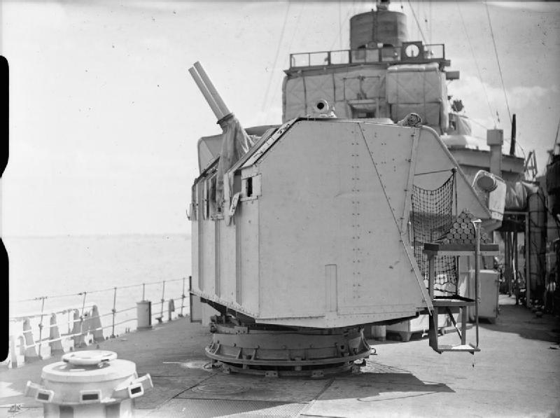

Side view of twin 6-pdr on HMS Mackay
IWM photograph A 18740

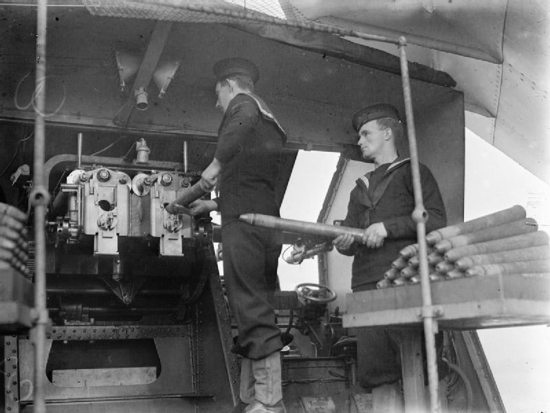

Loading drill on HMS Mackay
IWM photograph A 20313
