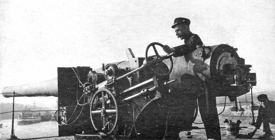

6"/26 (15.2 cm) Mark II/III gun in VCP mounting on ex-Cunard liner HMTS Franconia
Inspecting the gun is Senior Second Engineer Samuel Birks
Franconia was sunk by the German submarine UB47 off Malta, 4 October 1916, but SSE Birks survived to serve on another converted Cunard liner, Caronia.  He was awarded the Board of Trade Silver Medal for Gallantry at Sea for his part in fighting a major fire in the bunkers of this ship.
Photograph of "Great Uncle Sam" copyrighted by Jill Elton-Wall and used here by her kind permission
