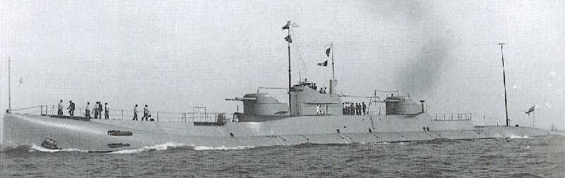

This weapon was specifically developed for the submarine X 1, which was the British version of the "submarine cruiser."  These were submarines with large-caliber armament built by Germany during World War I and by other nations during the 1920s.  None of these boats were very successful.
For the X 1, the design concept was that she should be able sink or disable a destroyer at 6,000 yards (5,500 m) with her guns alone.  In practice, this was unlikely, as the low height above the water of the range finding equipment and the unsteady nature of a submarine made this craft unsuitable as a gun platform.  This was the only gun of this caliber built by the British and was considered to be reliable once the initial problems had been overcome.
Consisted of tapered inner A tube, A tube, partial jacket, and breech ring.  Used a horizontal sliding, hand operated breech block with semi-automatic opening.  A total of six guns were built.
Submarine Cruiser X 1
World Ship Society Photograph
