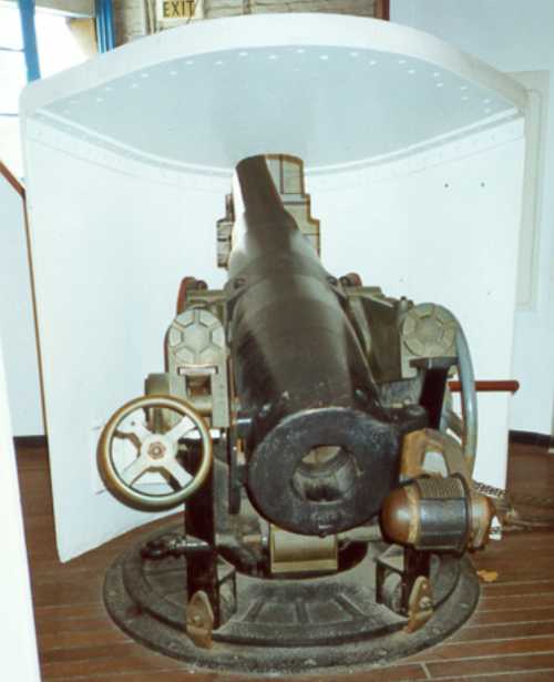

5"/25 (12.7 cm) Mark III gun on Vavasseur Mark I (VCPI) slide mounting
This gun was originally mounted on HMS Gannett and is now at the World Naval Base, formerly Chatham Naval Dockyard, Kent
Picture copyrighted by Bob Cordery of Colonial Wargamming
