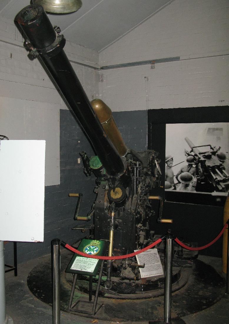

Constructed with a monobloc loose barrel and breech ring.  The bore and external parallel section were nickel plated and zinc protective plates were on the breech ring and horizontal sliding breech block.  A total of thirty-one guns were manufactured.  Actual bore length was 33.04 calibers.
4"/33 (10.2 cm) gun from HMS Andrew now at the Royal Navy Submarine Museum, Gosport, Hampshire, UK
Photograph copyrighted by Geni

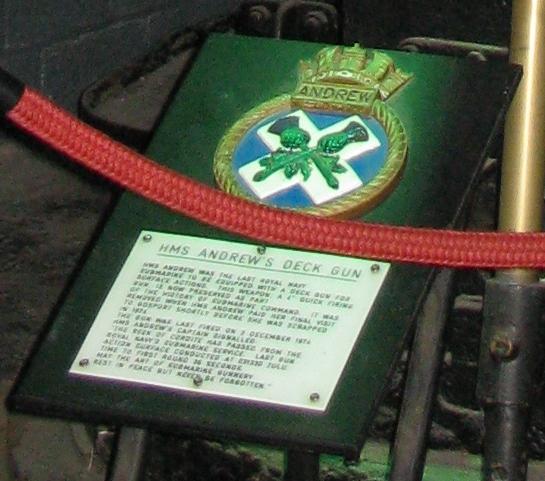

Plaque for above gun
Notable on this plaque are the following:  "HMS Andrew was the last Royal Navy Submarine to be equipped with a deck gun for surface action" and "The gun was last fired on 2 December 1974"
