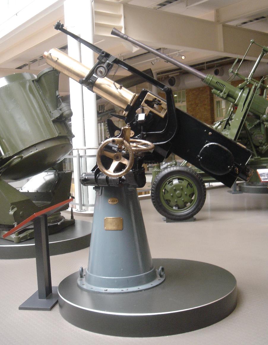

1-pdr. on AA mounting at the Imperial War Museum in London, UK
Note air-cooled 40 mm Bofors at right
Photograph copyrighted by Shane Rogers

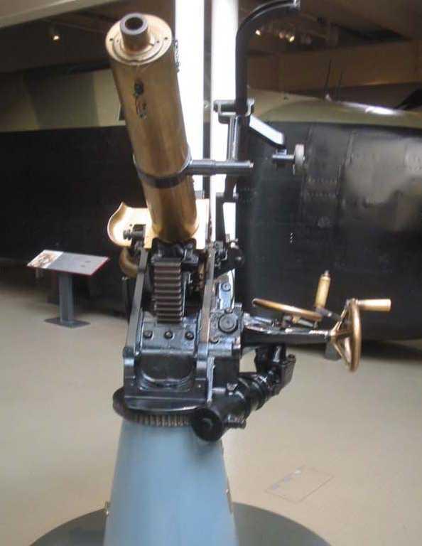

Front view of 1-pdr at the Imperial War Museum

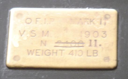

Identity Plate on above weapon
Q.F.I.P Mark II = Quick Fire 1-Pounder Mark II
VSM = Vickers & Sons, Maxim
