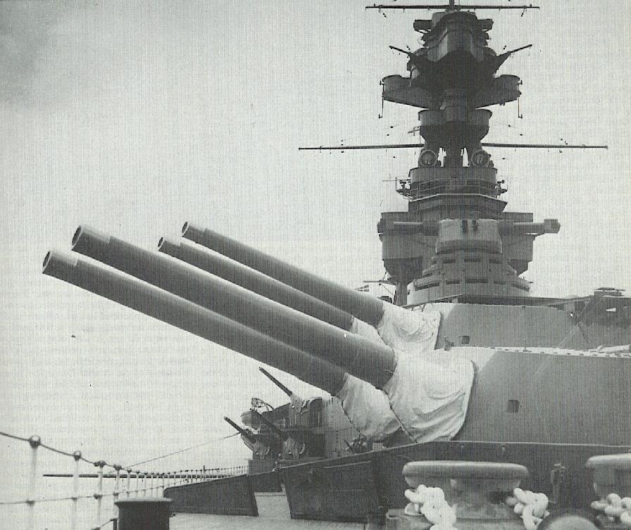

Forward Turrets of HMS Hood in 1932
Note the 5.5" (14 cm) secondary guns
