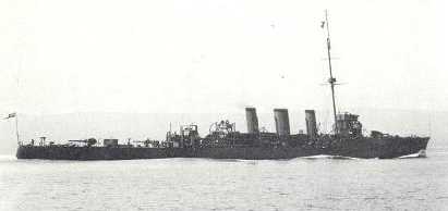

HMS Undaunted
This ship carried two 1.5-pdr weapons in 1918
NMM Photograph
