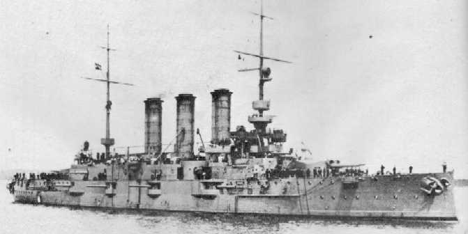

Erzherzog Karl
The 19 cm (7.48") guns are in the casemate mountings and amidship turrets
