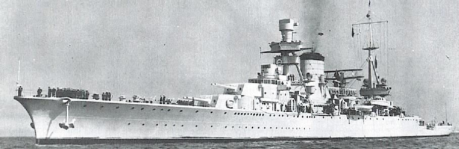

Used on the only "Treaty" cruisers ever to serve in a South American Navy.  Built by OTO at La-Foce and Livorno, Italy, these cruisers were considered to be very successful.
Argentina Heavy Cruiser Veintecinco de Mayo
USN Photograph
