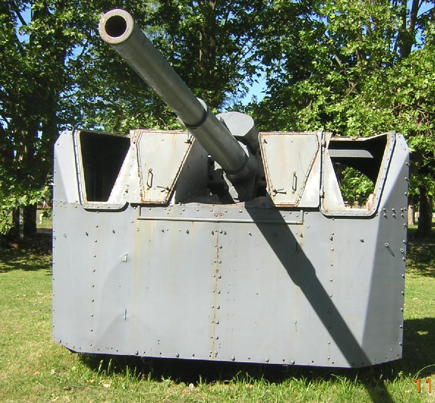

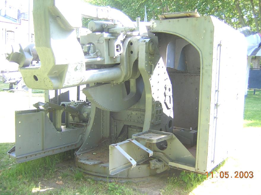

Used only on La Argentina, this was a loose barrel AA gun with a horizontally sliding breech block.
This weapon is described as having a vertically sliding breech block in "Naval Weapons of World War Two" but the photograph below shows quite clearly that it is horizontally sliding.

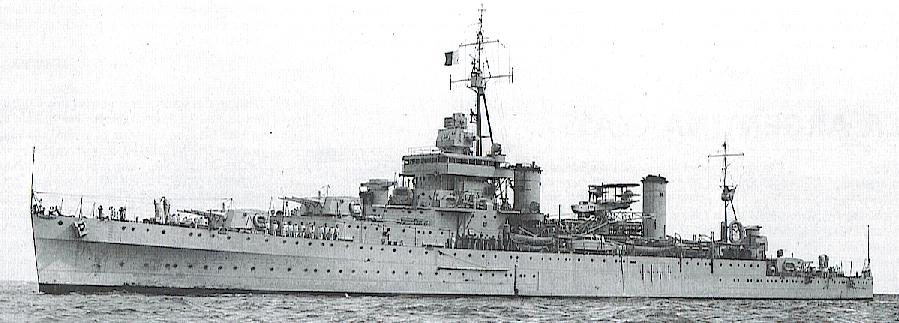

La Argentina in 1950
4"/50 (10.2 cm) mounting now on display at Museo Naval de la Nación, Buenos Aires, Argentina
Photograph copyrighted by Carlos Mey and used here by his kind permission
Rear view of 4"/50 (10.2 cm) mounting now on display at Museo Naval de la Nación, Buenos Aires, Argentina
